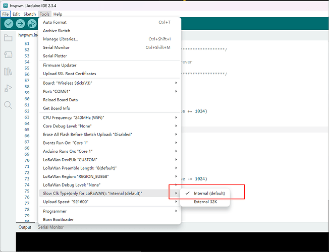

Second try:
Library Heltec ESP32 Dev-Boards has been declared precompiled:
Using precompiled library in c:\Users\kangu\Documents\Arduino\libraries\Heltec_ESP32_Dev-Boards\src\esp32s3
c:/users/kangu/appdata/local/arduino15/packages/heltec-esp32/tools/esp-xs3/2302/bin/…/lib/gcc/xtensa-esp32s3-elf/12.2.0/…/…/…/…/xtensa-esp32s3-elf/bin/ld.exe: C:\Users\kangu\AppData\Local\arduino\sketches\29016CBE147ABD0E1F6A78A05E425BC5\sketch\WiFi_LoRa_32_V3_FactoryTest_V2.ino.cpp.o:(.literal._Z5setupv+0x8): undefined reference to `ex_32k_start_cnt’
collect2.exe: error: ld returned 1 exit status
exit status 1
Compilation error: exit status 1

NOTHING COMPILES!
The code does not use the external 32K crystal, so there will be no problem if you choose this one.
The code on GitHub has been updated, but the release has not yet been updated. We will release a new version release after accumulating some updates.
