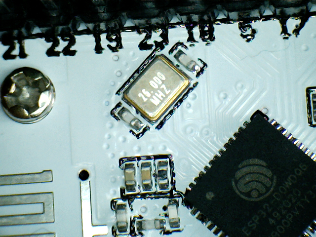

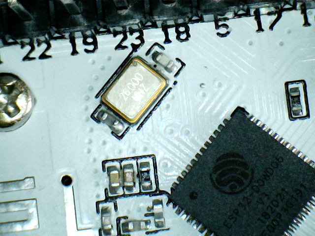

Hi,
I have just taken some images with a USB microscope and it looks like the units not working with I2C all have ESP32-D0WDQ6 v3 ESP32’s installed the ones that work have ESP32-D0WDQ6 is anyone aware of if this causes any issues on the I2C bus?
S20220227_003 S20220227_004
I don’t know what the specific problem is. ESP32-D0WDQ6 v3 and ESP32-D0WDQ6 should be similar, and the manuals use the same one
