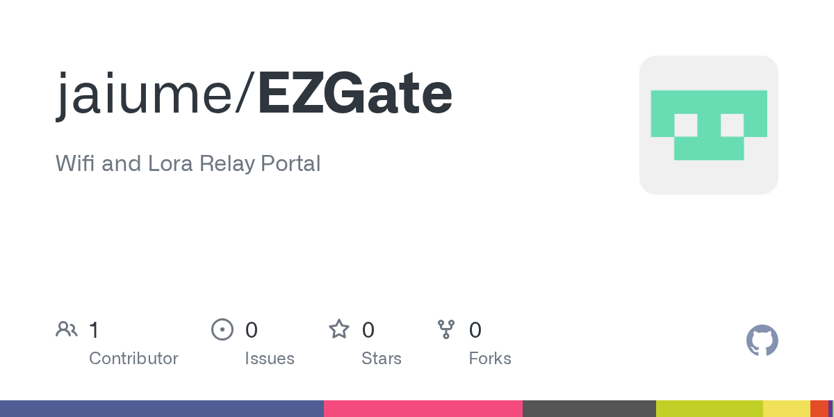

The repository is GPL-3.0 and includes both the PlatformIO firmware and the operator portal:
The firmware notes cover the pinout, the LoRa parent selection, and the OTA chunking. The 915 MHz setting is in the firmware config if you need a different band.
