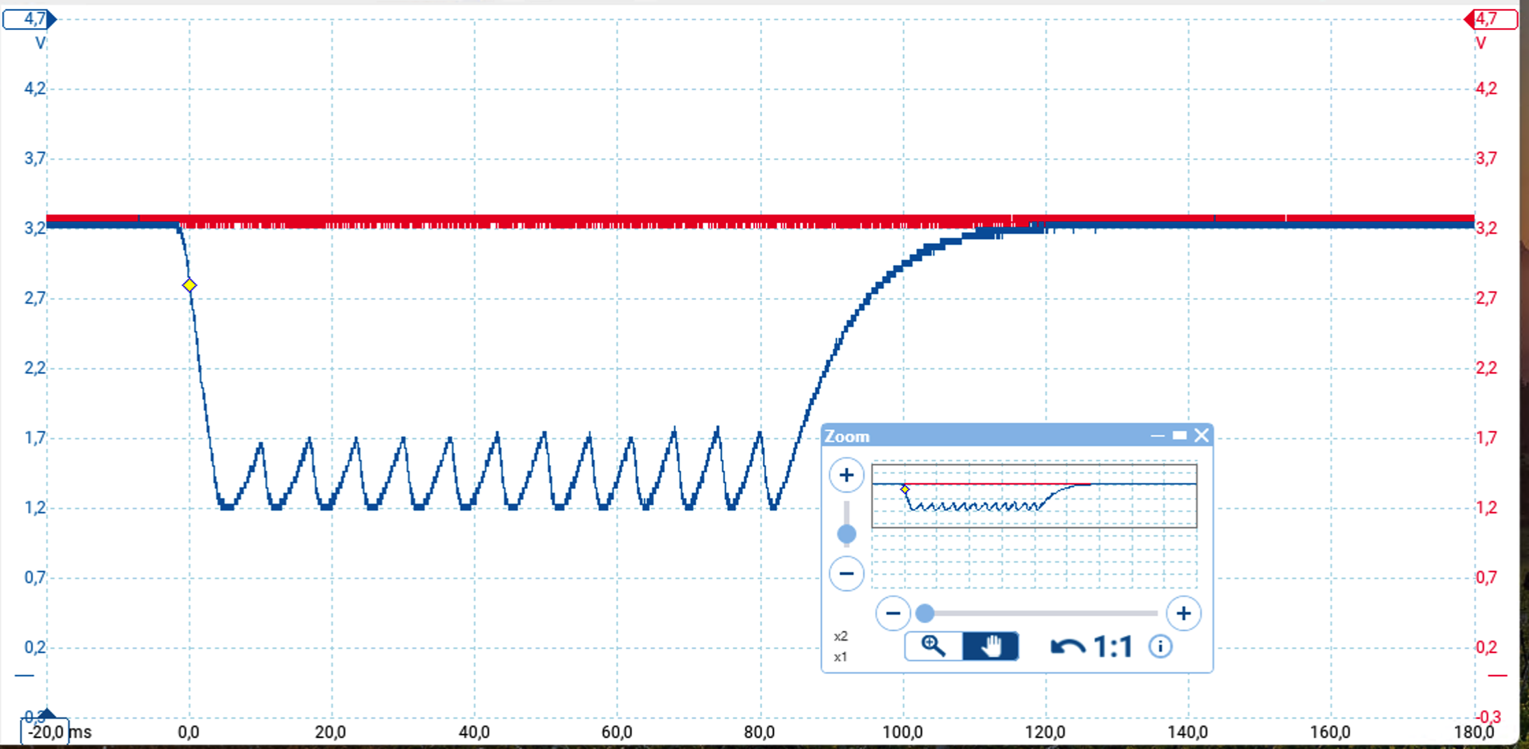

But, if the deep sleep lasts more than around one hour the ESP32 wakes ups in time but the reset reason is ESP_RST_POWERON as if someone pushed the RST button.

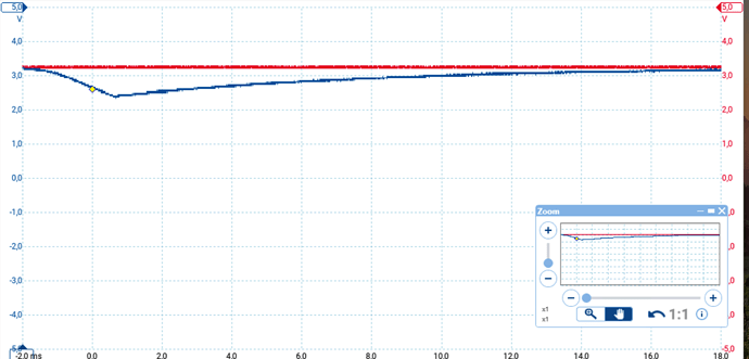

In this case I can see some kind of strange ripple on the CHIP_PU (Reset) line. This starts exactly when the ESP wakes up by the timer and causes the ESP to reset because of the voltage drop on the reset pin.
Blue line is CHIP_PU (Reset), red is Vdd 3V3 to prove a stable supply.

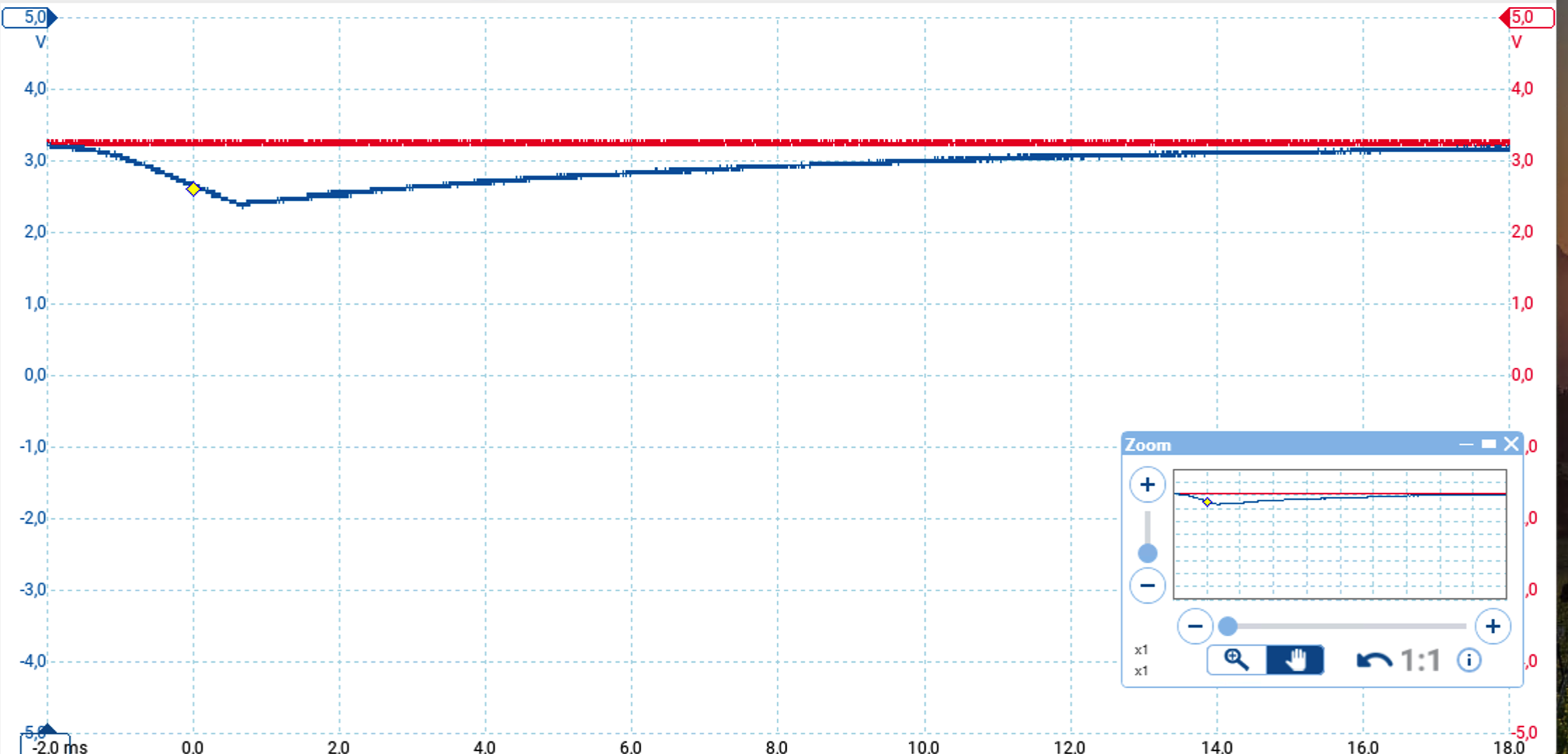

Even if the ESP does not reset - when the deep sleep lasted less than around an hour, there is a voltage drop on the reset line. But only a short one and not as deep. So the ESP does not reset.

So here is the voltage drop when the ESP wakes up from deep sleep less than around one hour.
