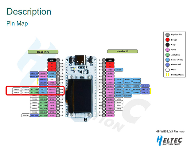

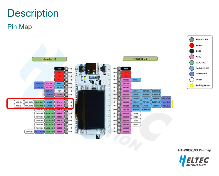

I am trying to see if it is possible to use the native USB port of the ESP32-S3 on the Heltec WiFi Kit 32 (v3). I see GPIO20 has USB D+ and GPIO19 has USB D- but for the Heltec library support, it does not seem have anything like TinyUSB or another library. Espressif seems to say it is actually a full OTG port that can be used as Host or Peripheral, which would be very powerful.

In principle, this is feasible. You may verify it by testing with a USB fly-wire connection.
