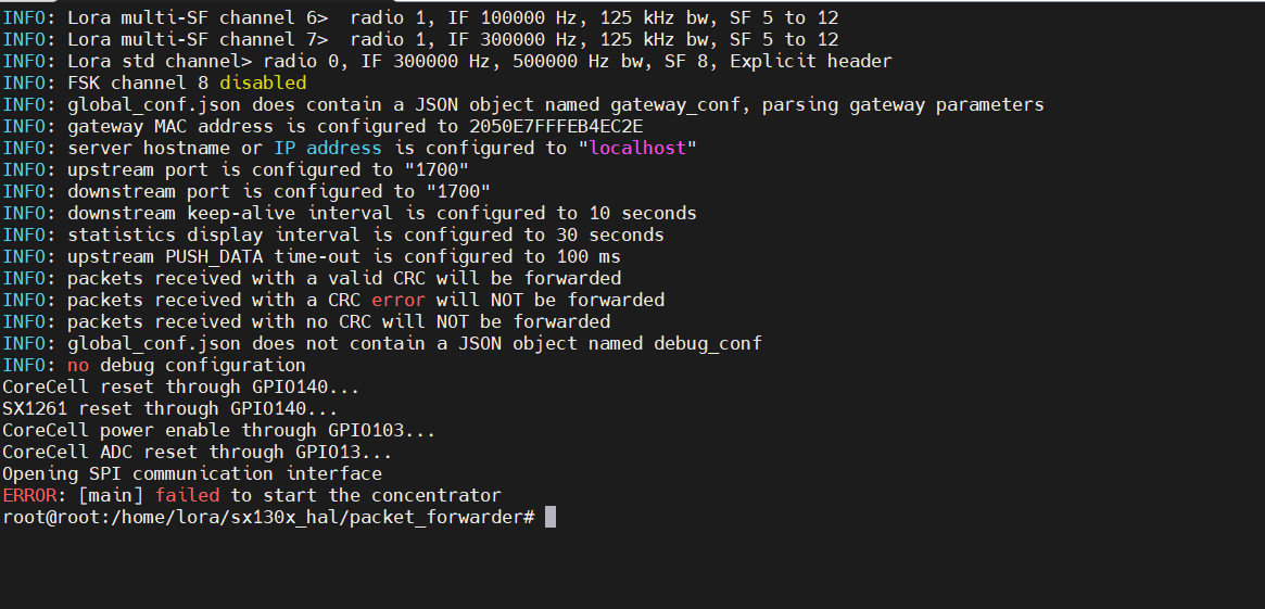

Dear Sir/Madam,
I have encountered the following issue when I tried to run the program ./lora_pkt_fwd
May I know what is the possible issue. Thanks.
  1. Check if the 1303 module is properly plugged in.
  2. Check if the dip switch position of the adapter board is correct.
    If both of the above are fine, recompile the firmware and try running it again.
Did you find a solution? I’ve already tried everything, including reinstalling all the hardware, but nothing has worked.
Hi,
I encountered the same issue. I don’t think it can work for this product. In addition, no support from Heltec. There is no upgrade on their image, and the version is already EOL.
