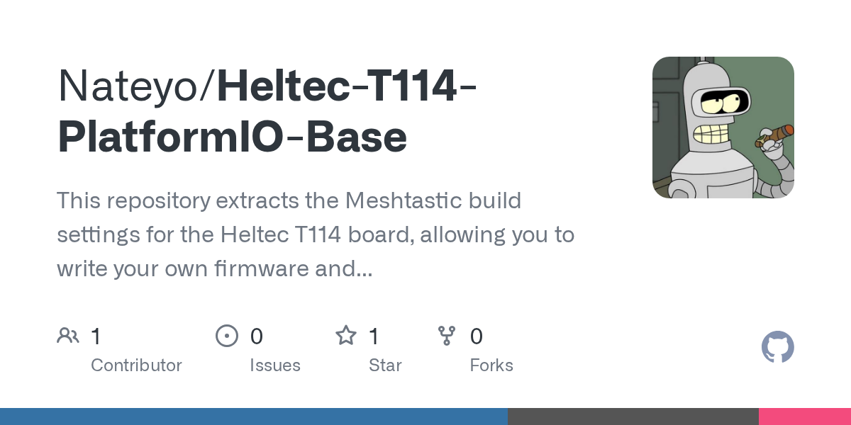

Sorry to necromance this thread. This was the top google result when I was looking for instructions on how to work with the T114s in platformIO, and I was frustrated that there wasn’t a way out of the box, so I made a base repo which can be utilized to work with the T114 and platformIO seamlessly, thanks to the great work the meshtastic team did in figuring it out already.
