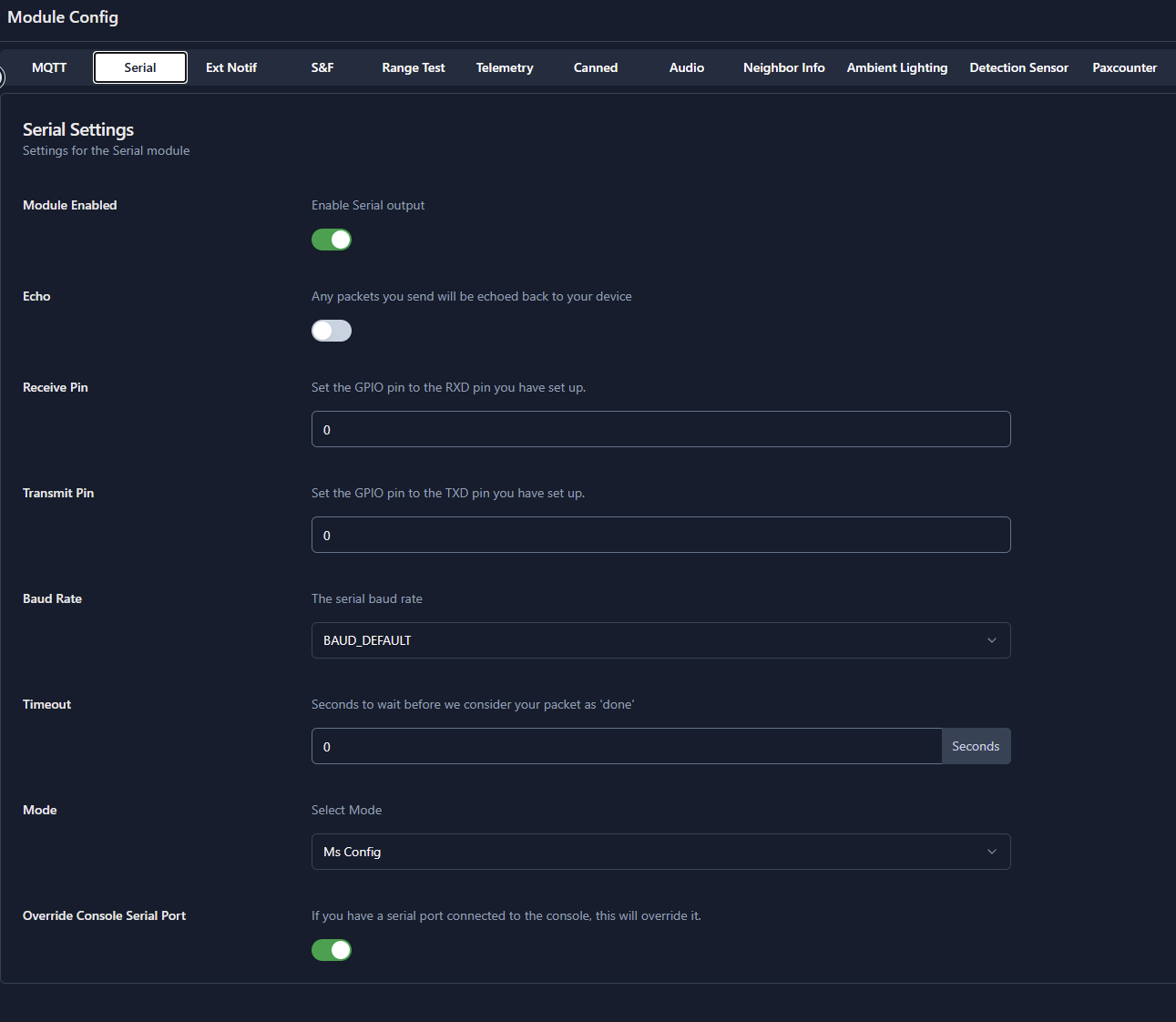

Detail screenshot
I have this working in addition to
Override Console Serial Port ENABLE
If you have a serial port connected to the console, this will override it.
