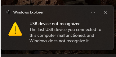

I have a MeshPocket that I attempted to update using my Android Phone via Meshtastic app’s OWA feature. The BT connection between the two was severed during the update and now I cannot connect the device to my Windows 11 computer, nor do I get the DFU virtual drive mounted so I can paste a firmware to it. The screen just shows the last message I had sent to it before performing the OWA.
Error when connecting MeshPocket to computer using the firmware update cable:
USB device not recognized
The last USB device you connected to this computer malfunctioned, and Windows does not recognize it.
Heltec%20USB|374x186
I have tried draining the battery from the MP, charging it up all the way, double-pressing RST button but each time it tries to connect to my computer, it shows the USB error.
Is it done for?
