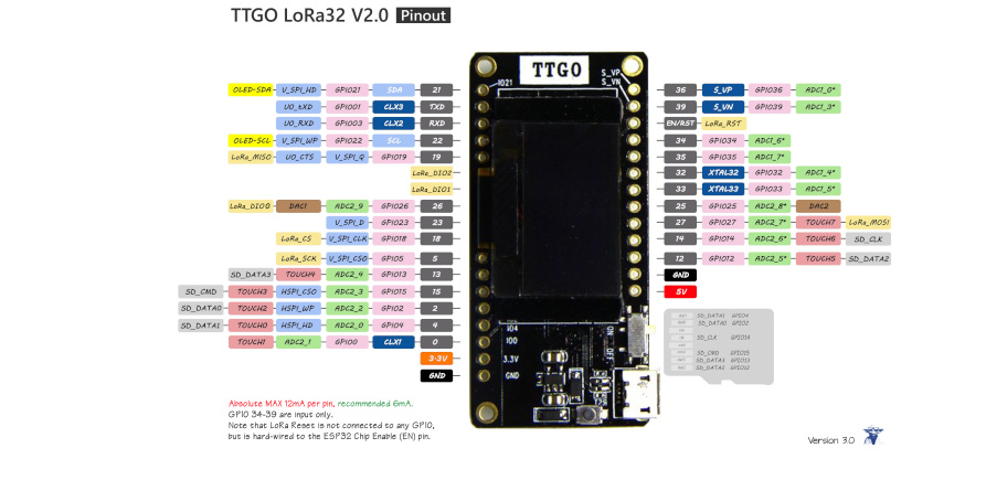

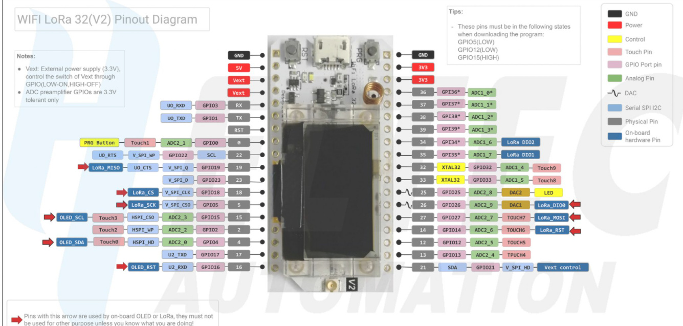

I2c connection on lora32 module v2
Hello.
I used heltec V2 module.
and I tested it with the i2c_scanner_heltecesp.ino example.
and, mpu-6000 sensor is connected.
here is source, my arduino settings. and I used GPIO 21,22

is this a hardware fault?
I have anoter lora32 module under picture. in same environments, only different development board.(wifi lora32 v2->wifi lora32) it’s works normally.

Can I check something else?
