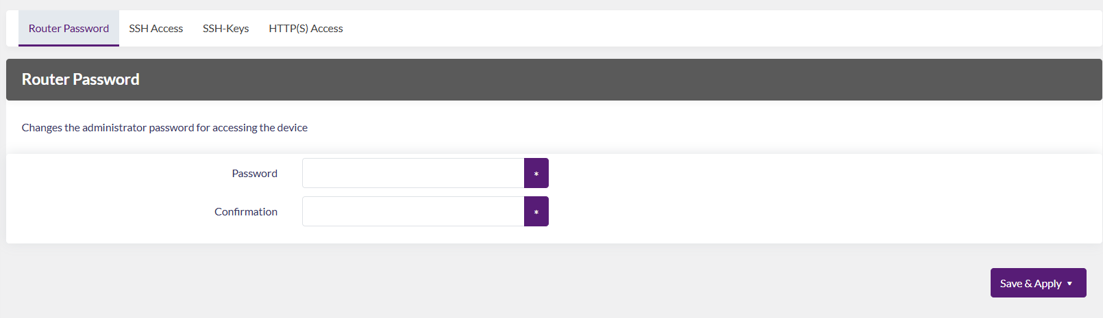

The save button seems to be missing from the administrator password screen on the HT-HD01 HaLow Dongle.
I would like to change the default password to something a bit more secure.
Am I missing the save link somewhere on the page?
I have tried multiple browsers
weak and strong passwords followed by rebooting
it seems there is no way to save a new password available on the page anywhere
help???
HT-HD01 Missing save button on administrator password screen
I have the same issue.
Did you get to manage it?
How to change the password
Could you please share your experience?

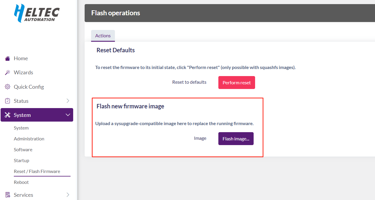

https://resource.heltec.cn/download/HT-HD01/firmware/HT-HD01-V1-20250807.bin
In the latest firmware, this issue has been fixed and you can upgrade to the latest firmware.
