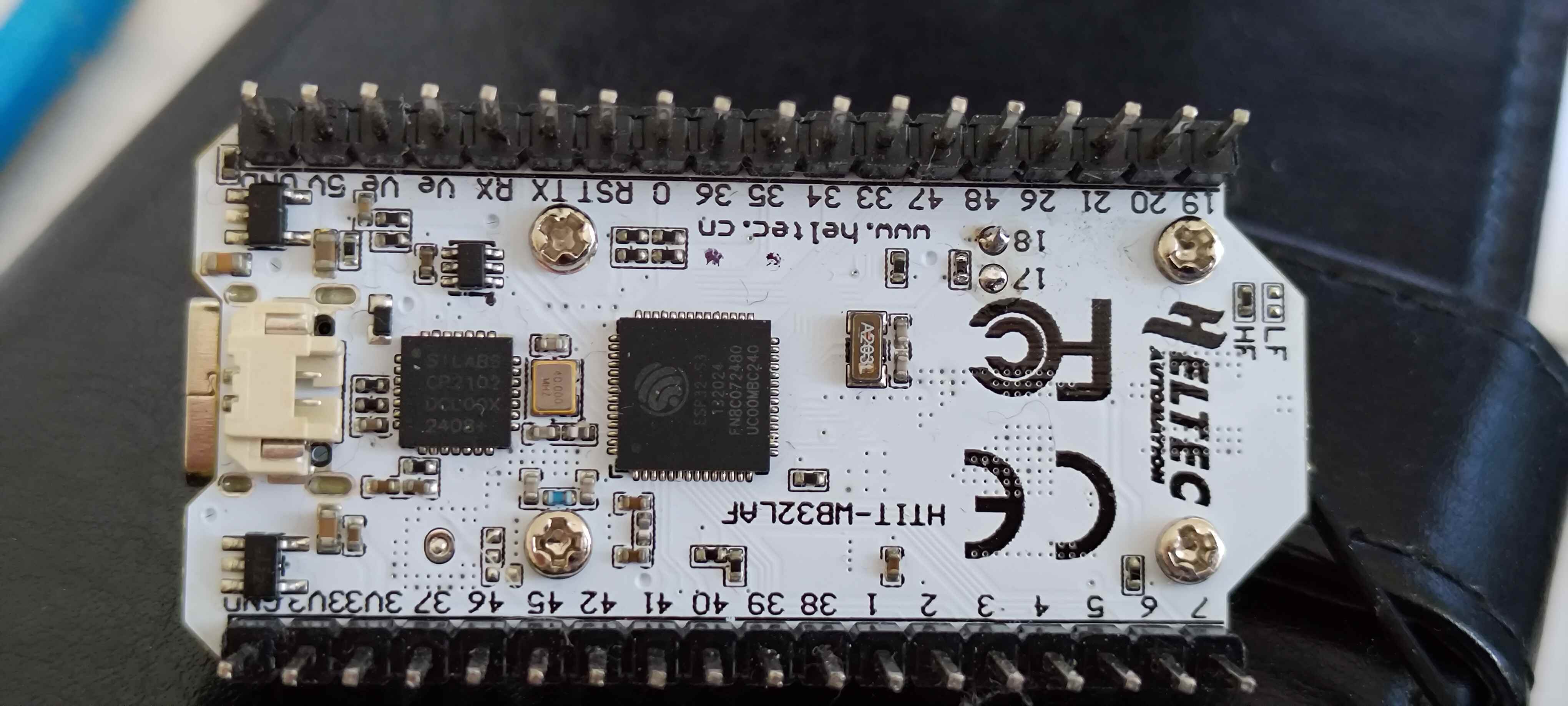

I have this model heltec V3, and see that the pinouts are different wherever I look.
Can someone tell me what number the named pins are please?

Apart from Tx/Rx, the rest of the named pins don’t have numbers as they aren’t programable and apart from Reset, don’t connect directly to the MCU, they just provide power.
Tread with caution on Tx/Rx - it’s connected to the Serial to USB chip.
There is a pin map with lots of details on the product page.
Would probably be easier if you told us what you were trying to do so we can give you SAFE advice so no magic smoke is released from your board.

There is only one product page for the Heltec v3 aka WiFi LoRa 32(V3). There are three variants, 3.0, 3.1 & 3.2, all have the revision clearly marked on the top side of the module but all have identical pinouts as you can see by looking at the schematics.
As a bonus, the part number on the bottom, HTIT-WB32LAF, allows Google to take you straight to the product page …
