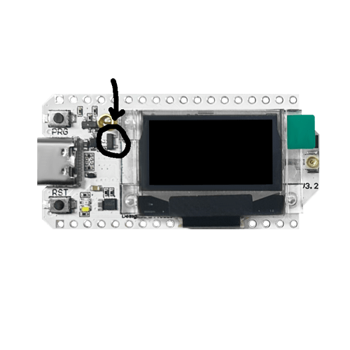

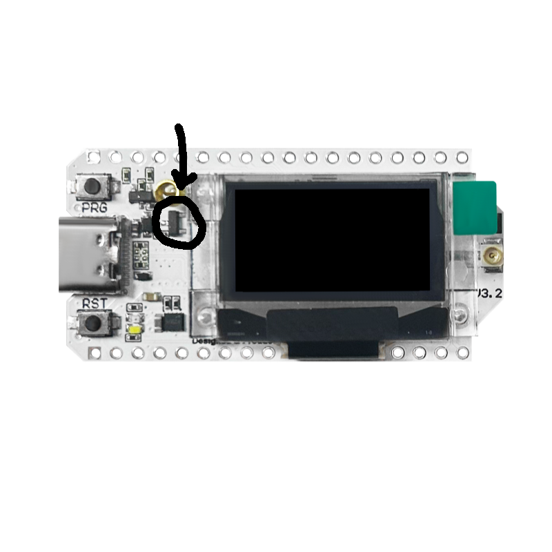

Can anyone help identify the component circled in the picture?
I have two new Heltec V3.2 boards that have burned out this component. They were both fine on USB power flashing the Meshtastic firmware. I connected a battery with the board outside of the case, which worked both to power the unit and charge the battery. However, when I tried to install the unit into one of the MuziWorks H1 style cases that I had printed, it overheated and burned out the circled component when I tried to snap on the back. I thought that I was compressing things too much (the antenna and battery wires are too long), so I printed the ‘large’ version of the case which should have had more room for the extra wires. Unfortunately, the same thing happened to the second board even with the larger case back.
No other components appear heat damaged and the boards power up and function with USB power so I assume that it is something in the LiPo charging / power circuit, but the component is burned/cracked badly enough that I can’t read the markings.
I’m hoping to identify the issue so I can avoid repeating the problem with any future Heltec boards.

Comparing the V3.2 and V3.1 the upper left corner is the power supply section and they look identical. The component on my V3.1 board in that physical area is labeled A19T
Since its a 3 pin component my “guess” is the mosfet labeled Q2 A03401.
I wouldn’t think that component should be generating much heat. Seems like something shorted out. Is the connector on your battery have the correct polarity?

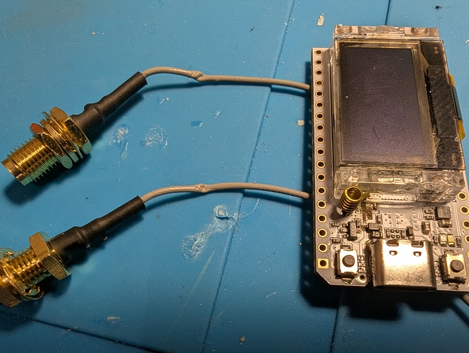

Looking at things closer, both of the antenna cables have been pinched. Currently they both test fine - no shorts. If they were pinched and shorted during the install would that have shorted through and burned out the component?
Thank you!
Thank you for the schematics. I think that you’re correct on the mosfet. The battery polarity was correct, it was fine for a day (including charging) until I tried to put in into the case that I 3D printed. I’ve added a post with what I think is the reason - a pinched antenna cable while assembling the case which I think must have shorted the board.

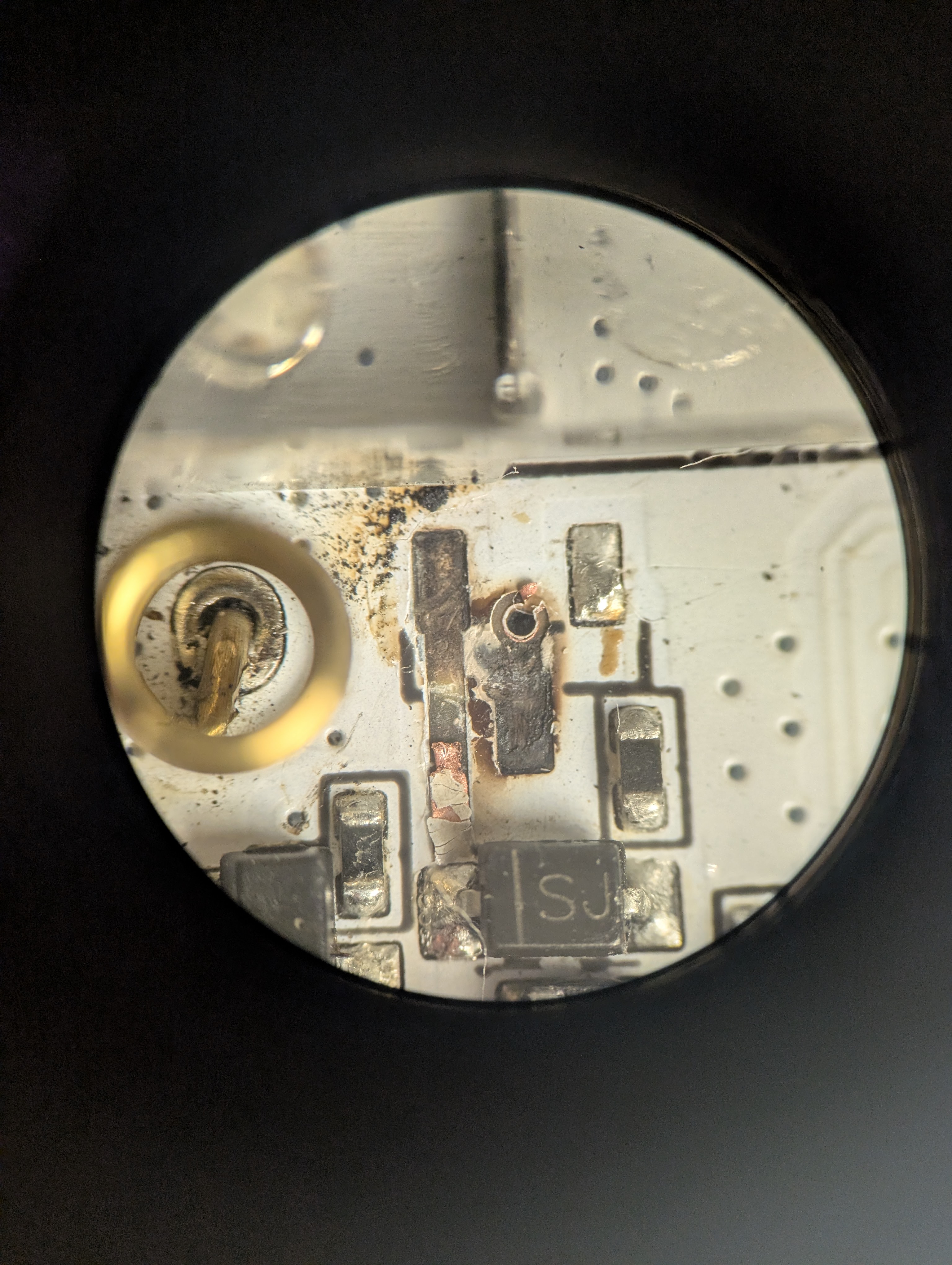

Looking at the board through the microscope it is interesting that clearly one side carried all the power, the trace is destroyed. One the other side, the pad is still in place and looks to be in good shape.
What was the outcome with this issue? I have just had Q2 (AO3401) go open circuit so that the battery will not power the board. About the pinched cable … if it shorted the outer to the inner you could place a high VSWR on the LoRa chip and maybe burn it out. The antenna output is DC blocked so any high current draw would be due to bad antenna match.
The part you have marked is Q4 as there is only one AO3400 (A19T) on the board.
