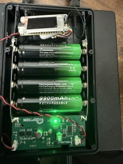

When I plug into the solar connector I only get a flashing orange light. The board does not light up. It will work when connected to the usb power. Do I have a bad board? The batteries are fully charged.image0%20(1)
which of the SH1.25-2P connectors are you connecting too?
try the LiPo connector
I use the equivalent to power my Heltec WiFi32 LoRa V4 board
Thanks you! I am up and running now.
Did you connect to solar or battery?
I connected mine to battery and it work.
