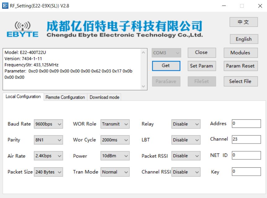

This USB module is based on SX1268 Lora chip and here is default module settings i am using:

I can’t get TX/RX packets between those devices! Help me please to set up correctly.
