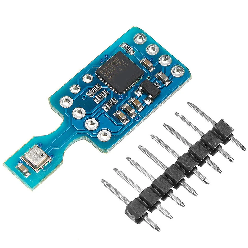

hello @wasn
does the configurator support GY-MCU680V1 BME680 Sensor Module ? I have tested cjcmu bme680 it works fine, but not GY-MCU680V1 BME680.
Kindly confirm.
That is the board with the serial interface right?
How have you connected it?
I may be wrong but there are no pullup resistors on the iic signal lines.
yes, this is the one
I have connected using the i2c, connected to TCA9548A
Try with 4.7k resistors as pullups on both scl and sca lines
