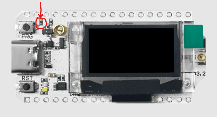

I was soldering a GPS into my Heltec v3 3.2, and accidentally removed this resistor:
I think it has to do with 3.3v / 5v power - the GPS won’t get a lock unless I plug in the USB charger.
Also, when I hold the button down to put it in Shutdown mode, it automatically wakes back up in 2 seconds.
Any help would be appreciated.
I suppose is a 10K pullup resistor for prg key
