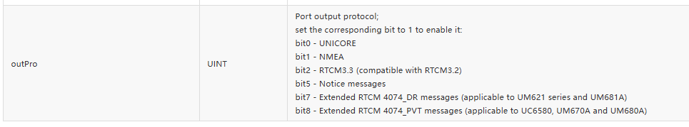

Hi folks, has anyone here already tried activating the PVT messages via the CFG-PRT?
:slight_smile:
Nope, where’s that from? Go ahead, try and report! :slight_smile:
It’s from the UC6560 protocol, and unlike the NMEA sentences, the complete information is provided in a different message format. :slight_smile: I also tried contacting the support team of the GNSS module, but I didn’t receive any information.
