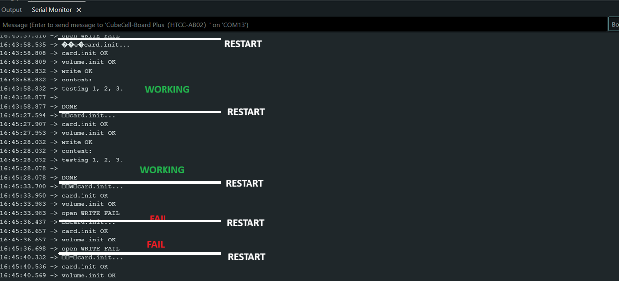

But when I tried the “read/write” example, it soedn’t works… Actually, it works sometimes, only once and then I have to plug it again. my code is below
. I tried different speeds of SPI bus.
I also tried to remove the “read” part. Still the same : Sometimes it Works, sometimes not.
Here is an example of my serial monitor, when I unplug the re-plug my AB02.
