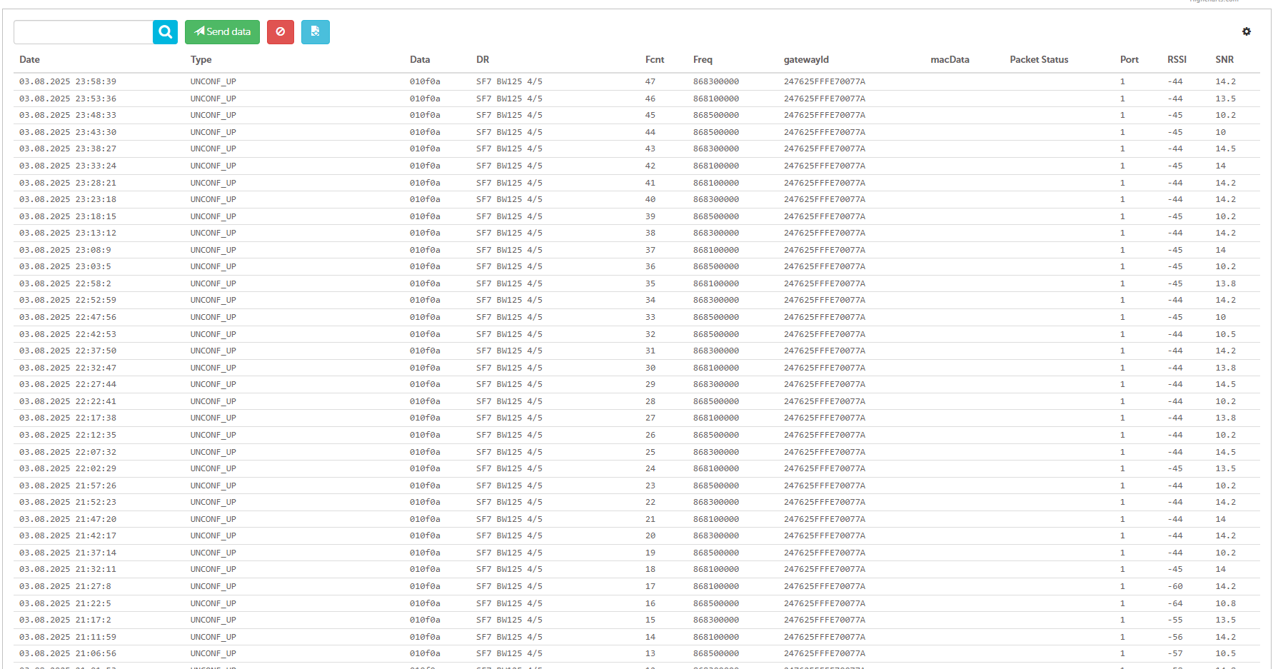

In my case, it doesn’t matter. The device will be located along a gas pipe, thousands of kilometers away from any life at all. Send a message SF12 without confirmation once a day. Receiving information from the base station is not provided at all.
Look at this. This is the traffic for the last 24 hours. Only outgoing packets on the timer. Nothing extra. Perfect.
